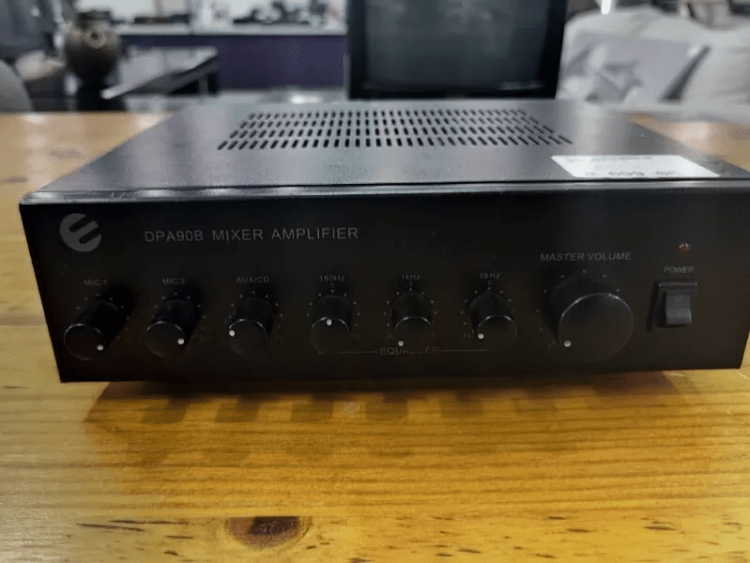

DPA-90B Mixer Amplifier

So what is the difference between a Preamp and Amplifier?
Think of a preamp as a weak signal booster and the amp as an enhancer, refiner and producer of high quality sound.
A lot of audio amplifiers in the market have a two-stage signal processing system consisting of pre-amplifier and amplifier. These two components are inbuilt within the device, so you won’t need a separate pre-amplifier. The pre-amplifier is highly sensitive, designed to pick up weak audio signals from a microphone. It amplifies the microphone audio input by as much as 1000 times, bringing the audio to line-levels which can then be transmitted to the final or end amplifier which boosts the signals further, enhancing them for speaker reception and activation as well as audio appeal for listeners.
In recording studios, PA systems and other high level commercial systems, pre-amplifiers are rarely used because mixers can perform the pre-amplification role quite well. Standalone preamplifiers are another option if your amplifier doesn’t have one integrated, but it’s very to find these in use or being sold in the market. The advantage of a separate preamplifier is that it is free from the amplifier, therefore it is not affected by internal noise caused by the power amplifier. However, the disadvantage of a separate device is the matching difficulties and compatibility issues between the two connections, making it difficult to achieve the required synergy for optimum performance.
Some home stereo and hi-fi systems including TV have inbuilt amplifiers which power the speakers. However, standalone amplifiers can be purchased and connected to the speakers. It’s very important to know that a weak signal from a microphone and other inputs (e.g. turntable, record, CD, cassette or digital player) will be amplified by a different amount depending on the type of amplifier. Class A amplifiers are the best and commercial systems will produce more powerful outputs than home systems. There is a huge different between a club and home stereo amp. The former is more powerful.

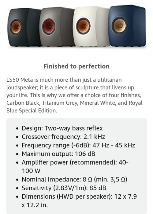

LS50 Meta 2-way reflex bass speaker
Frequency range: 47Hz to 45KHz (45,000Hz)

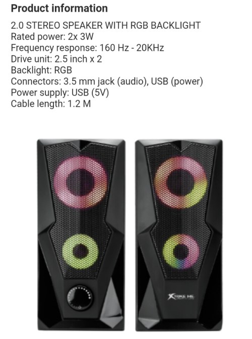

XTRIKE-ME 2.0 stereo speaker with RGB backlight
Frequency range: 160Hz to 20KHz (20,000Hz)

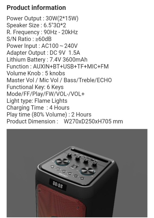

BRAND 2x6.5 inch Big Power Wireless Party Speaker
BRAND 2×6.5 inch Big Power Wireless Party Speaker
Frequency range: 90Hz to 20KHz (20,000Hz)

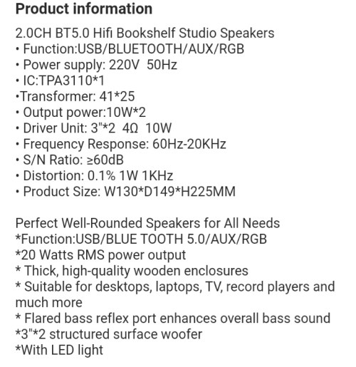

2.0CH BT5.0 Hi-fi Bookshelf Studio Speakers
Frequency range: 60Hz to 20KHz (20,000Hz)

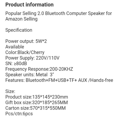

2.0 Bluetooth Computer Speaker
Frequency range: 200Hz to 20KHz (20,000Hz)

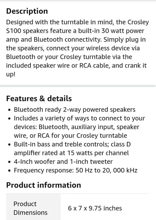

Crosley S100A-BK Bluetooth 2-Way Stereo Speakers
Frequency range: 50Hz to 20KHz (20,000Hz)
If you noticed above, a speaker like XTRIKE-ME 2.0 only supports the upper band of the bass frequency range. It doesn’t go lower than 160Hz, whereas a speaker like LS50 Meta covers a wider bass frequency range, going as low as 47Hz. This is a speaker you would like to buy if you are interested in a deeper bass. The lower the minimum the better.
A speaker like XTRIKE-ME 2.0 is fine if you don’t care about a richer/deeper bass. What if you bought this speaker and you want to improve its bass? This is where a subwoofer comes in. In this case, you must get a subwoofer that will go deeper than 160Hz to your preferred minimum for example 50Hz. Subwoofers can go deeper than 50Hz, down to a minimum of 25Hz or 20Hz which is the lower threshold of hearing.

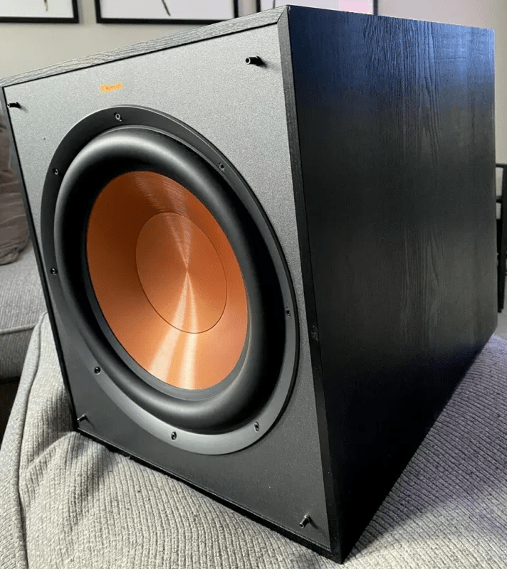

How Does a Subwoofer Get to this Lowest Hz?
What Hz is required to increase bass? The answer lies in the previous formulas we discussed about the efficiency of a speaker. The bigger the size of the speaker (cone diameter), the better the bass. As you have realized, subwoofers often come as standalone speakers because they are too big to be integrated in compact speakers such as bookshelves. There is an economic limit at which the size of a speaker can be. It cannot be too big for packaging and transportation as this will drive up costs. Consumers also expect products that won’t take up too much space or stick out like a sore thumb. That’s the reason why most stereo speakers don’t have a built-in subwoofer as it takes up too much space.
To fire up the bass in your stereo, you have to connect it to a subwoofer. A subwoofer is often larger than your stereo, which shows you how much of bass power it packs. There are two types of subwoofers, the passive and active subwoofer. The former is powered by an external amplifier and the later is powered by an inbuilt amplifier. Active subwoofers have a more powerful and deeper bass.

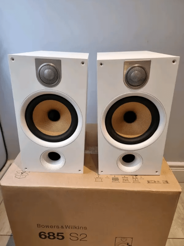

Bookshelf speakers are worth it if you are not entertaining a crowd (small, medium or large audience). They are not suitable for entertainment of commercial proportions, for example clubs, home parties and outdoor events. What defines a bookshelf speaker is its compact size which can fit in well inside your room without stealing the limelight, standing out or taking a lot of space. It’s made to fit in aesthetically and harmoniously with your furniture without grabbing attention. Another main feature of this speaker is its fully-detached speaker cabinet which can be placed anywhere in your room. This speaker is placed on top of furniture such as shelves, tables, desks, drawers, cupboards and stands. It can also fit inside an open-face compartment.
A bookshelf-speaker is worth it if you have a small room, which allows to enjoy its near-field performance and reach. If you have a large room, it should be strategically placed near your sitting position in the corner. Two speakers can be arranged in an equilateral triangular setting with their front face facing the focal point (the listener) and at an angle of 60 degrees from the base. This position ensures an optimum dispersion of sound waves in the listener’s direction.

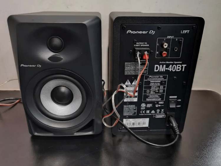

Pioneer DJ DM-40BT Studio Monitor
Studio monitors also known as monitor speakers are quite different from bookshelf speakers in that the former is used for audio/music production in recording studios to generate clean/natural audio without effects, distortions, alterations or manipulations, whereas the later are for home entertainment purposes. The source audio in consumer entertainment speakers such as the bookshelf speaker comes out in manipulated form to enhance the listening experience and enjoyment of music. Monitors are the opposite, they are not made to enhance or boost the audio, but to filter out all the environmental effects and influences which may alter the source audio. They are designed to give you the raw output which is close as possible to the raw input. At this point, one may be wondering what type of environmental influences will affect raw audio.

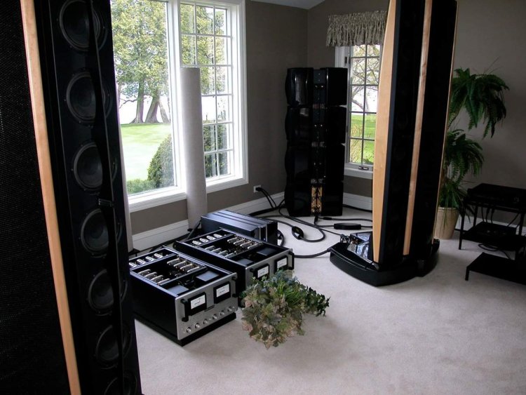

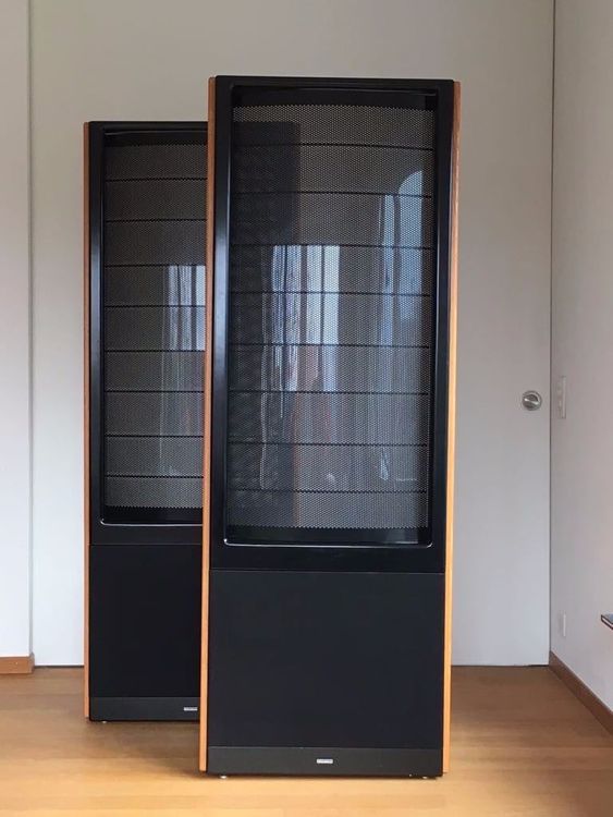

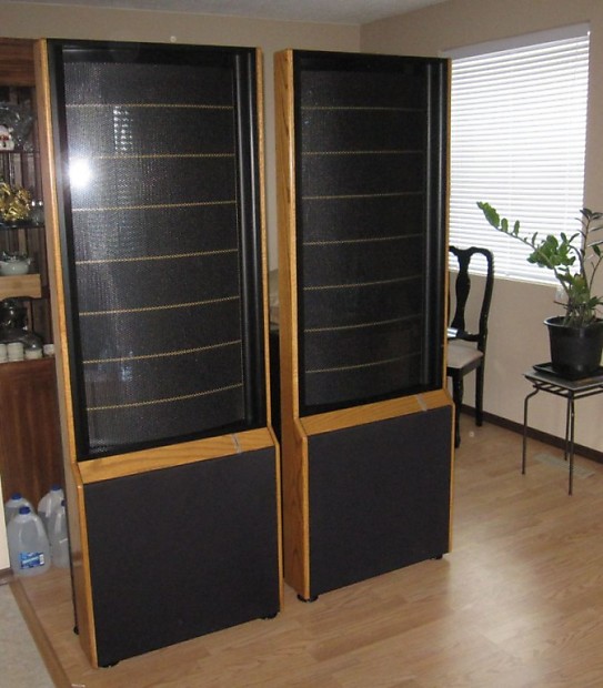

MartinLogan Statement e2 Twin Tower Speakers Copy
MartinLogan Statement e2 Twin Tower Speakers - 1998 Model

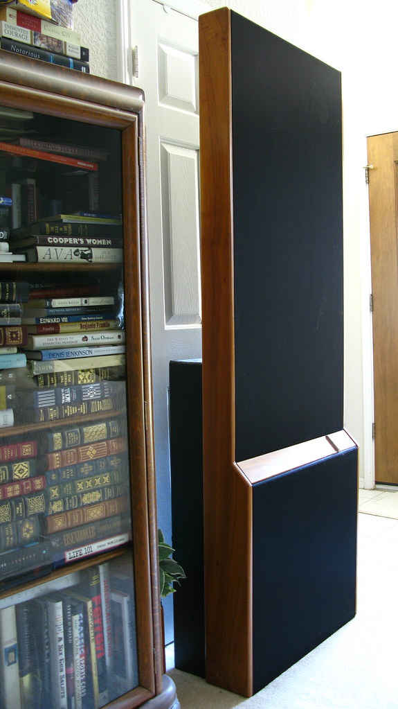

Towers are tall floorstanding speakers with a narrow profile. There is a reason why these speakers may be associated with outdated vintage speakers for some people, but whatever you think, towers aren’t stuck in the 1970s or 80s. They have evolved and improved to much better modern standards, design and performance just like other devices. But let’s go into the past and look at the history of speakers.
Yamaha the Japanese electronics company made its first Natural Sound speaker in 1967, the NS-30 and NS-20. The speaker had a tall rectangular profile with a narrow edge made of brown-stained wood. The company produced their first 3-way speaker in 1972, model NS-690/NS-670 which had a plain wood box enclosure, tall but with a wider breadth. This model was popular with audiophiles around the world. Two years later they produced a 3-way monitor speaker, the NS-1000M, a model with a beryllium diaphragm (a world-first) enclosed in a black modernistic skin that is synonymous with speakers today. In 1978, Yamaha launched the return of the traditional plain wood speaker cabinet, but this time it was stained with a brown varnish. The NS-451 was an entry-level model incorporating a trademark white cone on its low-frequency driver. The company continued making tall cabinet/box speakers made of wood or wood composites until 2003, with new models produced each 1 to 3 years. Yamaha had produced 16 models from 1967 to 2003. Obviously, they have designed and manufactured many more models since 2003, and what you have to keep in mind is that the tower box speaker commonly known as the “tower” is going nowhere. It is here to stay. It has taken new functional forms, being adopted even for Bluetooth speakers, home theatre systems while its traditional use as a powerful bass-reflex system is still intact in clubs, parties, bars and other crowd functions. A modern floorstanding tower speaker has a much more visually appealing aesthetic design which makes it more attractive than a vintage box. Major electronic hifi companies and retailers are still selling the tower, and it’s doesn’t look like your typical vintage box.
In the USA, MartinLogan is a speaker design/manufacturing installation company specializing in wireless systems, soundbars, subwoofers, architectural and outdoor systems. Their roots can be traced back to the 1970s when the founders Sutherland and Sanders formed a company based on their interest in speakers. In the early days, the challenge in speaker design was producing bass levels and wider ranges. The KLH model 9 and Quad ESL were the only promising and outstanding speakesr which sought to jump this hurdle. The former was too expensive for consumer success and the later was a hit in England.
Sutherland and Sanders presented their first experimental model in 1980. It was a thin tall rectangular aluminium frame with five bars, wires, linked with an amplifier and powered by electricity. The sound was good but the range couldn’t be increased as the prototype blew up on increasing the volume. A series of experiments with high-tech materials solved the arcing problem and later on theoretical solutions led to the design of the CLS transducer (curvilinear line source transducer) which achieved high frequency ranges while preserving sound quality. Their CLS prototype was showcased in 1982 at a consumer electronics exhibition in Chicago. This transducer received a CES Engineering Award and became an instant success. This allowed MartinLogan Corporation to garner the support and input of innovative engineering experts such as the manufacturers of NASA space shuttle windows and Teflon non-stick cooking pans. The team came up with a patented system comprising a 5,000V transparent diaphragm and stator coating with a maximum charging capacity of 10,000V. The speaker known as the “Monolith”was enclosed in a tall, flat, narrow-edged rectangular wooden panel . Its sound quality was demonstrated in 1983 at a showroom, attracting dealers and creating a demand in the market. Not only was the sound good but its thin minimalistic appearance was aesthetically pleasing as well. By 1985, the Monolith was generating huge sales enough to make a profit. Sales increased by 1000% (10 times as much) in 1988 necessitating the need for expansion and mass production. As competition grew in the market, MartinLogan turned to home theatres to keep up with consumer trends, producing a center-channel electrostatic speaker and wall surround-channel speakers which were a first of its kind.
The company continued innovating and engineering while producing some of the best visually appealing speakers in the world which contrasted greatly with the box vintage speakers of the day. The home theatres found a place in the market, propelling them to a major brand name in the USA. In 1998, MartinLogan unveiled their huge high-end twin-tower speaker system called the “Statement e2”. The futuristic design of the “Statement e2” deserves an award. It was ahead of its time, you wouldn’t call it a vintage tower if you saw it today. It’s still one of the most good-looking tower speakers out there, blowing away the competition by miles. The Statement e2 consists of two separate towers which includes an 8-bass driver tower. This was one of the most expensive speakers, retailing at $100,000 in 2003, but the model was discontinued in 2006.
Interesting, but what’s the importance of this history? If you follow the timeline of speakers beginning in 1861, you will notice the evolution of speakers from phonographs (base and horn) to more powerful towers such as the Monolith and Statement e2. The tower represents power. The first electromagnetic speaker making use of electrical amplifiers was manufactured in 1921 by Edison-Tech. It was much better than the horn. The Edison electromagnetic speaker was housed inside a tall wooden cabinet. This was probably the first tower. Traditionally, wood has been used to build speaker cabinets because of its acoustic and mechanical properties, although MDF (medium density fibreboard) is another alternative that can be used. But certain types of wood (e.g. Russian birch plywood) remain the best for professional high-performance speakers.

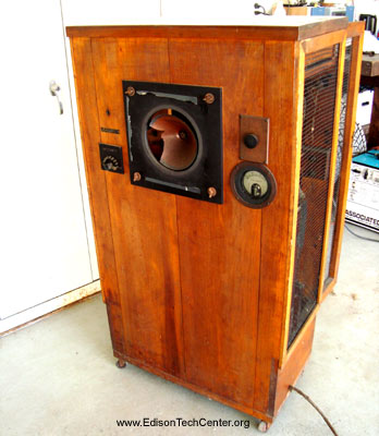

Edison Electromagnetic Cabinet Speaker 1921
First Tower - Edison Electromagnetic Cabinet Speaker 1921

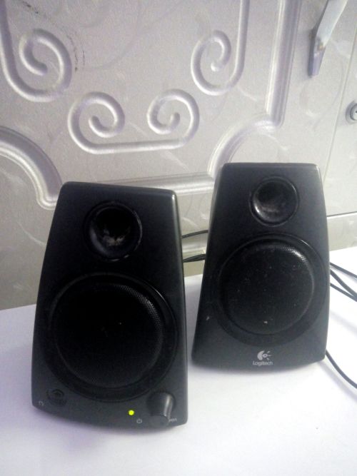

Logitech Wired Computer Speakers

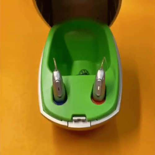

Phonak is an electronic hearing aid device that works with a pre-installed rechargeable battery. Some of their most common products are the Audeo Bolero, Marvel , Virto, Naida, Brio and Paradise models. The device comes in a small portable case that can be closed and opened. The case can fit in your pocket just like a cellphone and it keeps your device safe from contamination by weather elements such as dust, rain, wind and other particles which can interfere with the performance of your device. The case also functions as a charging station and bank.

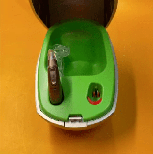

To charge your Audeo Marvel, do the following:
Your Marvel case has two charging ports for the left and right hearing devices, which are marked with different colours for clear identification.
Take your device and note the colour of its ear-mold. If the ear-mold is red, insert the device in the red charging port. If your ear-mold is blue, insert the device in the blue charging port.
Look at your device, there is a pivot push button which functions as a volume control. Press the bottom end of the button down and hold for 15 seconds. The indicator light will not come on. Put the device in the charger. The indicator light should come on. The light indicates the battery is charging.
behind-the-ear hearing aid
Phonak - charging the behind-the-ear hearing aid
To charge your Audeo M-R and Bolero M-PR device, do the following:
These electronic hearing aids come in a smaller compact case which is also functions as a charging station. The advantage of these models is that the charging procedures are much simpler.
Your Marvel case has two charging ports for the left and right hearing devices, which are marked clearly with different colours for easy identification.
Insert the device in the correct charging port. The light indicator will automatically turn on, flashing red, yellow or green light. Green indicates the battery is fully charged. Yellow indicates the battery capacity is mid-level and red is a warning sign for low capacity.
When the device is fully charged, take it out by grabbing and pulling it straight up.
A behind-the-ear hearing aid can also be charged in the same charging station/case. The blue port is for your left device and the red port is for your right device. However, since a behind-the-ear device is usually not colour-marked, you should insert it in the correct port by making sure the ear-mold is resting in the inner side of the case.
The light indicator should automatically turn on, flashing red, yellow or green when the device is placed in the charging port. Green indicates the battery is fully charged. Yellow indicates the battery capacity is mid-level and red is a warning sign for low capacity.
